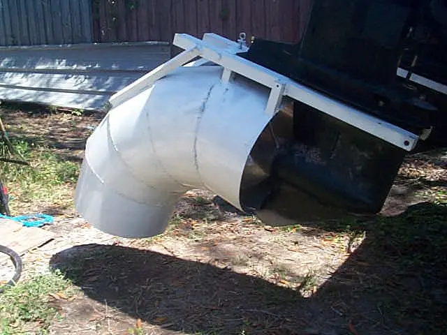

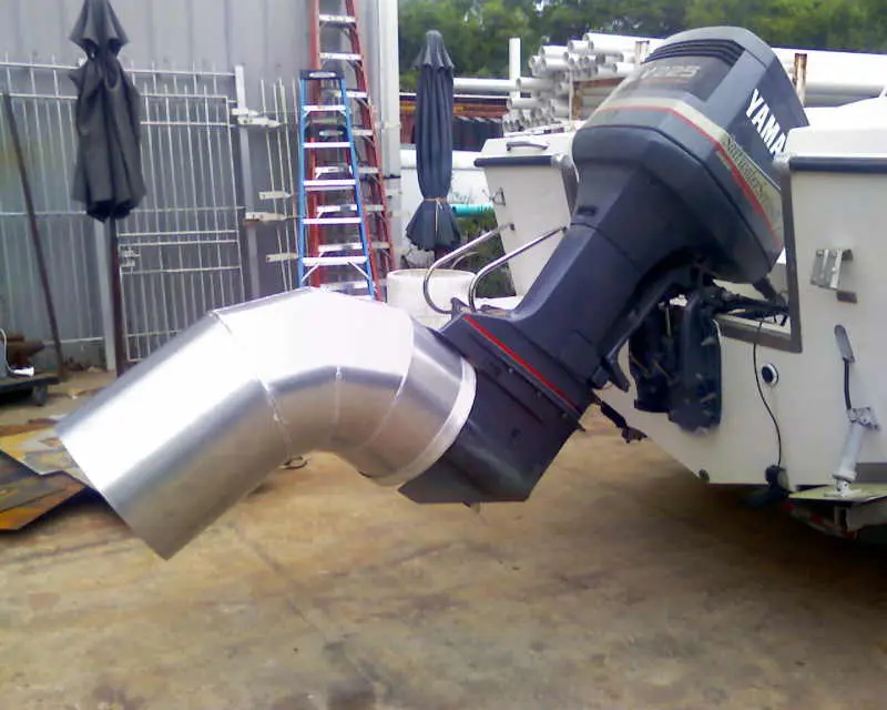

Here is one I made for my Yahmaha 225. Its 18" diameter and has a 2' longer down tube to help blow in deeper water. I also have a picture of another smaller one on a 25 horse outboard that I will post later.
This pict is before we put the mounting brackets on. Will try to post those later as well. I think there are some picts in another topic if you do search.

Cornelius,
I did the design work and templates but a friend did the welding at HIS shop. I did the fitting and installtion as well. I haven't learned how to weld Aluminum successfully yet! I tried down in Cocoa when we were installing the blowers on the Conquistador, but it was a futile attempt.
I will leave that up to the pros for now!

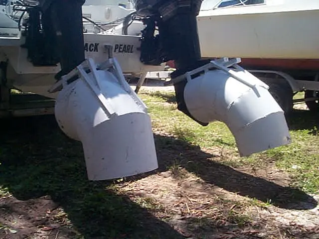

Here is a picture of the blowers I made for my outboards. They work great.
