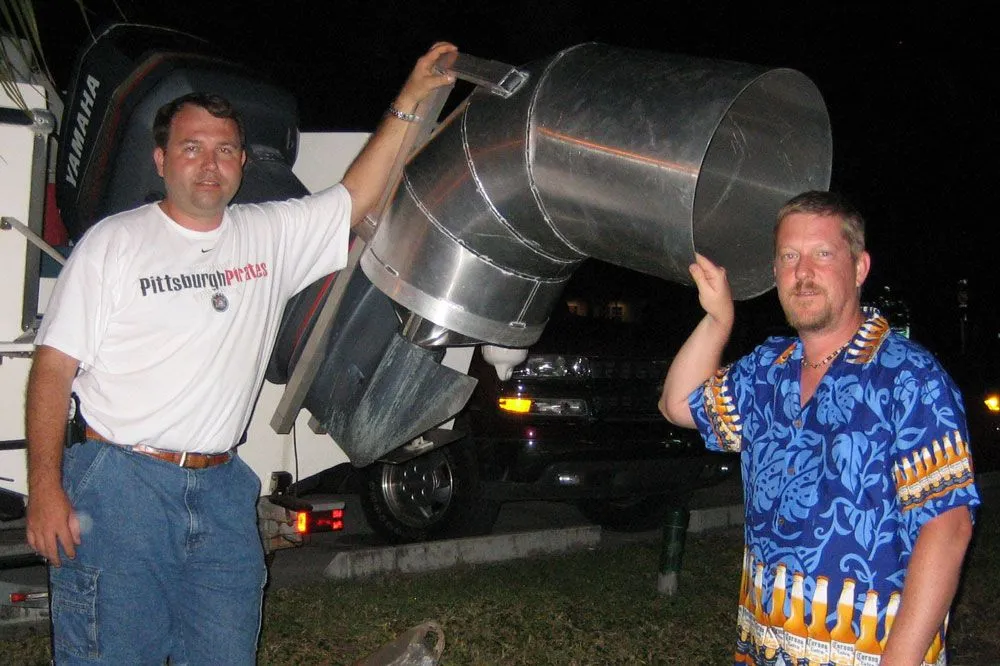

18" diameter mailbox on a Yamaha 225 Outboard and in 15' of water, we were able to blow a hole 3-4' deep and 15' in diameter. I would definitely say it would be better with a shallower angle and in shallower water. Maybe 10' or less would be better.
By the way, its For Sale if anyone is interested! $1200 or best offer!

RGecy said:
Here is one I made for my Yahmaha 225. Its 18" diameter and has a 2' longer down tube to help blow in deeper water. I also have a picture of another smaller one on a 25 horse outboard that I will post later.
This pict is before we put the mounting brackets on. Will try to post those later as well. I think there are some picts in another topic if you do search.

I am not sure where that image is anymore. It was from a news article clipping talking about treasure hunting and was actually posted originally by someone else back around 2004. The blower was attached to the motor by a pivoting frame attached near the cowling.
The one on the 25hp was probably 14-16" in diameter.
I am actually considering modifying the 18" blower above and removing the 2' extension. This will make the blower blow a little more out than straight down and maybe help clear the hole a little better. This would also help keep the sand and shells from coming back in to the water pump.
Robert

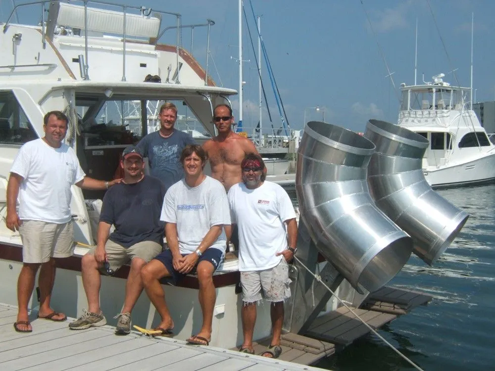

Not being involved in dive oriented treasure hunting I am curious about the blower set ups. The usage makes perfect sense, and in the case of these outboard driven models I see how they would be really quite useful in shallower waters. I have seen in passing pictures of much larger boats that have 2 blowers on them that at least by scale in the picture look to be 24" or better across. Are these still useful only in shallow waters (say up to 10-15 feet) or does the much larger size give them a substantial depth increase?
-Lance
Our former boat the Conquistador has dual 24" blowers and can blow in 30' of water no problem. Some of the larger vessels with 48-54" blowers can blow in 50'+ of water. Engine and prop size are certainly important. Some vessels have added longer down tubes to help when blowing in deeper water.
