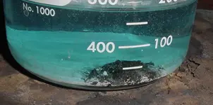

For those who enjoy seeing gold refining, I have posted some pics in the past...however now they are buried. We do this a couple times a week recycling gold into new jewelry etc.
First pic is the acid eating away the gold

If you want to learn more about what I just did, please learn from others at www.goldrefiningforum.com/

two ways to do it, high karat gold, disolve the gold and silver is left behind, or low karat junk, add silver and remove it via nitric, leaving the gold behind.
Its the difference between AR and Inquartation. After inquarting I use AR and that gets it extra pure.
Whats left in the bottom is simply collected and melted or needs a step or two before you can just melt it, Just depends what you are doing. There are many ways to refine metals. Since everything I do is just for either fine gold or for jewelry, I generaly just use the simple methods, Gold is the main thing I go for, silver as a byproduct and kind of annoying to deal with on the scale I do silver on. When I have enough silver to process I sometimes just take a day and do 30 to 50 ounces, otherwise even at $15-20 per ounce, its just not worth it for the scale I do it on. Gold is always worth it though.
