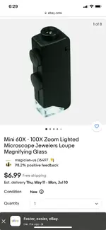

I just got a new toy in the mail and I would recommend it to anyone who would like to carry a portable microscope into the field…It is much smaller than my old one and I can see the little silver in my ore so much better…Here is a screen shot off of eBay…
I forgot to mention it came from China pretty darned fast but there might be sellers here in the USA…
