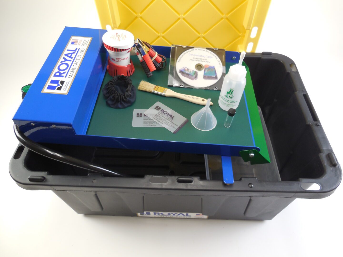

Reed, I have the Royal Miller Table, and I found out it's warped in the center by about 3/32 inch. This means that I can't get a proper water flow from side-to-side. I have just boxed the darn thing up, as I was so frustrated seeing gold move down the table when I had a side-to-side flow. Problem was the flow was too string because of the central warp.
I can't even use it as a finishing table, because of that warp. And no, seems they think I'm just not setting the thing up correctly. I watched their video on it, and did exactly what they said with no good results on anything but larger than 100 mesh gold.
I had a modicum of success with it, but mine isn't capable of catching the ultra fine gold. I may try again to get it tuned, but right now I consider it time consuming as compared to my panning.

With your description and having watched part of the Royal setup video..... I'm pretty sure you are setting it up at too steep an angle/trying to use it before proper setup is achieved.
Keep notching up the end equally and you will get the desired "flat water" flow. A miller table is most efficient when almost flat.

PS I would be inclined to start with a flat table and make angle adjustments dependent on feed size and processing speed... probably quicker as long as the waterfall is even.

Arizau, I probably need some kind of electronic level. I'll see if such exist in a small enough size for the table.
Don't bother. Any level will work if you want to use one. The video didn't did it?

It didn't, but I tend to do things backwards, unconsciously. So I need a digital level anyway, for daily tasks, like laying level concrete slabs for my chain mill when I move it out to my back-back yard.
It'll allow me to start with a flat surface, and I can make adjustments from there.
I do almost all my home repair and maintenance myself, so a new tools is always welcome.
Download the "Level App" to your phone. It's the best level around and it's free.
Like arizau said, use the Royal table and set it up almost flat. Even a warp in the center shouldn't matter because you adjust the table to the gold, . All you want is just the slightest angle in the very beginning, then you adjust it down to where the black sand starts to move, while leaving the gold in place. After that, you can steepen it a touch more, but you want the gold to barely move at the most.
