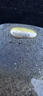

Nice test I don't think most of the miners on here are catching that micro gold. My cleanup sluice is rubber ribbed the whole length looks like floor mat controlling the water flow and some dish soap I'm catching micron gold. I need a loupe to even see it unless there's a lot here's some floating on top of a mercury ball looks like gold paint. Happy Mining
