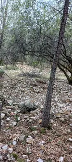

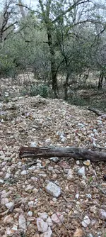

Gold Mining is great exercise and a chance for a payday most days its cheap entertainment. Finding rocks with micro gold is easy but finding rocks that are worthwhile is a gamble. I limit my prospecting / crushing rocks to a five-gallon pail full. It takes me all day to sample a pail full sometimes for a nickel's worth of gold the next time I'm doing the happy dance. I can walk out and gather a little at a time or a trailer behind a quad for a weeks' worth of samples. There's plenty of area to prospect and access to a few claims or take a short drive and fill my old pickup with a load of rocks. El Dorado County has 2,599 mine records in the USGS MRDS database, making it one of the top mining counties in the nation. Gold mines are the most common mine type, with 2,334 mines being listed with gold as a primary commodity. We have enough quartz to pick through to last a long time.
