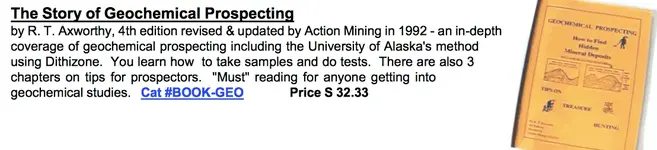

Sometimes an area just doesn't have big gold. The key is to set up to recover the type of gold that is there.
This book goes into a very detailed description of geochemical prospecting using Dithizone.
It is available through Action Mining
