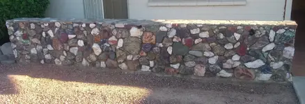

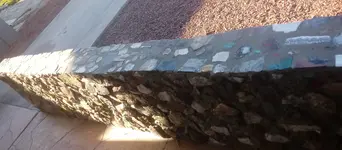

Okay. Cool. Thanks guys. I will do both of of those things. I'll take a look under a 🔎, then pan the crushed rock with a little added soap. I will be back with the results. In the meantime, heres what the wall looked like and some rocks that came from it. I can only imagine how many hours and dedication went into creating this. amazing work of art.

Do you think the wall was someone's rock collection? That's what it looks like. It indeed does look like an ore of a metal, with other stuff in it also. Do you or can you get a black light? It almost looks like the massive zinc ore from Franklin, NJ. I don't think it's western uraninite, but from the pics and no history its hard to tell.

Here in Butte Mt, there are old houses all over town that have walls made from ore rocks from the mines here, as well as from other areas. You could tell some of these miners were rockhounds too!!! Pretty cool wall by the way!:icon_thumleft: Oh yeah, I see pyrite as well as other sulfides, these guys steered you right IMO.
I see a lot of blue in that wall, look and see if you see anything like this, it's blue gem silica, the most valuable form of chalcedony and found here in Az. 8683268986_4c1dffebf8_b.webp

Second set of pictures (wall):
Mostly various forms of silica (quartz chalcedony...), some ironstone and ore of copper (green stuff) and granitic host rock.
It was taken from some old abandoned copper mine shaft probably.
