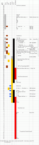

Haven't posted this for a while - so for the benefit of coin shooters: Here, on a scale of 0 to 99, are coins (and other common items) from my logbook and how they read.
