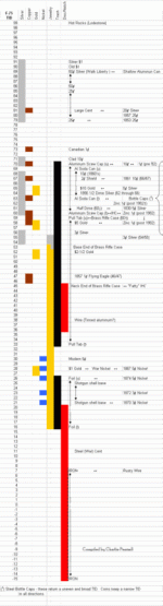

The blue on the chart below shows the notch I use in pavillion areas when I just want to pick coins.
And here are some targets I have dug or ground-tested and kept log of for TID results:
