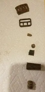

3 .44 partials dug in very close proximity but they are not from the same bullet. All (but the nose) show rifling marks. Why would someone cut bullets like this. Appears to be 2 bases and one nose?
Lastly, any info about the brass buckle? Period? use?
Of course, I;m very happy with the only coin found so far. 1868 Shield nickle, must have been almost new when lost.

It appears to me that you have a mixture of old and new and many pieces that I won’t attempt to ID.
Obviously the coin and the rim fire cases fit into the 1860’s and into the 1870’s sites. I can add that I have found a number of the small 2-prong buckles on the early pre-1880 sites I hunt.
On the military/Indian Wars related sites I hunt I only find rim fire casings and internally primed center fire casings. Externally primed casings did not show up until the early 1870’s.

Jason, nice finds. In the next to last pic., 2nd item down looks to be a U.S. brass Cavalry suspender buckle. I have one of these dropped by one of "Uncle Billy's" troopers here in Georgia.
Ah, thanks! Thats very possible for this site. Both military and civilians traveled this road
