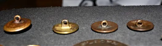

These buttons are for sale locally but I am a little suspect of their authenticity. The pictures are all I have to go on. I am going to see them tomorrow. Any opinions are appreciated.

They look fine to me
They all look good to me, you can tell by the amount of wear on the back of the buttons. :thumbsup:
As you know, most buttons that have been 'clothing worn' have wear to the face, where the backs often look pristine.
This is why we often find gilt buttons in the ground with gold still intact on the back but with nothing remaining on the face.
It may just be my eyes playing tricks on me, but I think I can see a backmark on this U.S. collar tab. :icon_scratch:

I like th US. The NC buttons mostly were thin stamped brass. Not sure if there was a period cast one. What does the backmark read on the SC? My eyes aren't working right this week.
As far as my old eyes can make it out I think it reads "Extra Gold Qual" with what looks like a lion or something like that. My problem with that button is the front is in excellent condition but the back is very worn. I think I will approach them as reproductions and offer him $5.00 each. I am not really interested in the US collar insignia but will buy it to get the others if I have to.
The NC 7-pointed "starburst" button at upper left is absolutely a Reproduction. It is solid-cast, not stamped-brass, and none of the Original 7-pointed ones were solid cast.
The other two solid-cast NC starburst buttons in the photo are probably also Reproductions. For 0one thing, you can check their precise diameter with a caliper. The Originals of NC 13 and NC-14 were 22mm.

The South Carolina "Palmetto Guards" button appears to be a stamped 2-piece, which is correct for that British-made button. But I've seen some amazing detailed 3-D printed Reproductions of 2-piece buttons that even have the crimp-line on the back. So, when you get to check this group of buttons in real-life, see it the Palmetto Guards is a 2-piece or a solid 1-piece.

But note, about halfway down that webpage, there are photos of a very well made Reproduction, which has the "weak backmark" we see on the one in the photo you posted. Considering that at least two of the others in the photo are Reproductions, the odds tend to favor the Palmetto Guards button also being a reproduction.
I wonder if the seller, who might be honest but ignorant, has any idea that well-made Reproductions do exist. Please give him the links I included above.... especially the Fake cast Palmetto Guards. There's a lot more at the Ridgeway Relic Archive's "main" section on Fakes, Reproductions, and Replicas:

TCG, thanks for the information and links. I don't think the seller knows what he has. I don't think he is trying to deceive me. As reproductions what would they be worth? I am thinking about $5.00 each.
edit: seller just contacted me and said his wife would drop them off for me to examine. I will get measurements then.
The seller had his wife drop these off a few minutes ago. I thought I would post pictures of everything she left before I even start researching them. the South Carolina button weighs 5/8th oz. and is 22.88mm in diameter. The North Carolina buttons are, from left to right in the picture, 1/4oz and 20.95mm with square shank. next one is 1/8th oz. and 21.41mm. Last one weighs 1/8th oz and is 20.95 mm. I haven't looked up any of the other stuff. He said he thought the skull was Nazi related?

The badge is a reproduction and the Cathouse token is a fantasy item. Skull and crossbones appears to be biker related or a fantasy item. No ideas yet on the pelican, pin or CSA token.
The skull and crossbones "Totenkopf" is a WW1 version, (search for Braunschweig Totenkopf) but there's something off about the shape of the skull compared to others I remember seeing. I wouldn't trust it to be original given the other items it's in with.
None will ever be worth over $5.00 if that helps.
I just took them to a fellow hunter and he had a real SC button to compare this one to. The one in question weighs twice as much and the detail is not as crisp. I am going to write everything off as reproductions or fantasy items. I may offer him $20.00 for the lot. If he takes it I will make a frame of fakes just to show folks.
