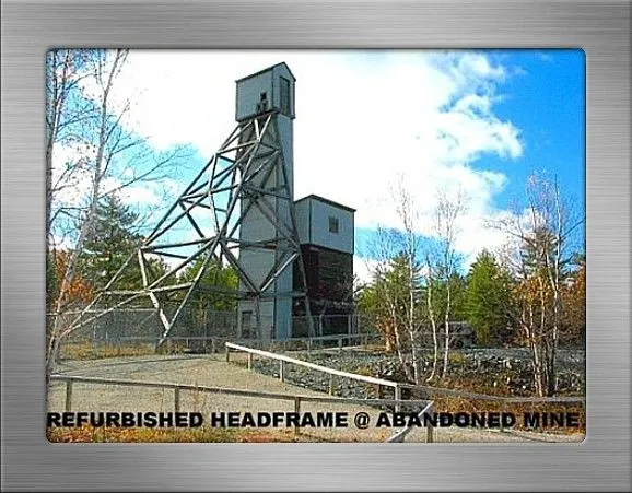

The photo immediately below depicts exposed bedrock on the outer fringe of a former mining camp that we revisited this past autumn. The next photo presents a few examples of small but good quality silver detected at this site in recent years. Most silver recoveries weighed less than one-half ozt, but it was fun MXT and F75 detecting because the signals were fairly abundant and mostly shallow for easy digging. Although small silver isn’t a priority, it is not easy to abandon patches that produce such good quality material in quantity.
COBALT LODE BEDROCK PROSPECT SF.webp​
Extensive information about abandoned gold and silver mines is available online, and many publications are available to prospective hobbyists. My personal favorites include a series entitled Rocks and Minerals for the Collector authored by Ann P. Sabrina, in association with the Geological Survey of Canada. These publications supply useful information pertaining to abandoned minesites throughout Canada. They provide road guides to accessible collecting locations, a brief history of a site’s mining operations, normally include production numbers for more prominent minerals such as cobalt, lead, zinc, nickel, copper, silver and gold, and usually provide a comprehensive list of mineral occurrences for each site.

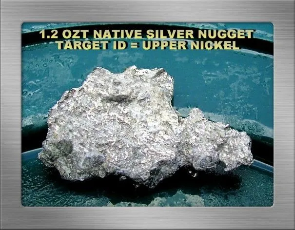

With specimen grade silver becoming increasingly difficult to find, it is more important than ever to use metal detectors suitable to the application, to select coil type and size that are appropriate for site conditions, and to avoid using discrimination modes if at all possible. Most readers would take this as an axiom, but we do see inappropriate metal detector designs or excessively large coils used in this area where pyrrhotite and other detectable minerals, abundant iron waste, and miscellaneous modern trash masking silver is problematic at many sites. Rather than review it here, we’ve previously discussed the topic of suitable metal detecting gear for silver hunting in northeastern Ontario in considerable detail at http://www.treasurenet.com/forums/canada/328287-electronic-prospecting-silver-country-part-2-a.html.
Below is a bit of plate silver detected with a White’s MXT 300 in the motion all-metal prospecting mode. The prospecting mode’s iron probability, numerical target ID indicator, and ground phase readouts add a lot of interest and fun to rockhunting, but it doesn’t influence our target evaluation routine insofar as overburden must be removed to acquire a strong target signal. If there is any doubt about the target ID, it must be dug to learn what produced the signal. No treatment was required for this sample other than a quick buff with the rotary tool, followed by a soapy wash and rinse.

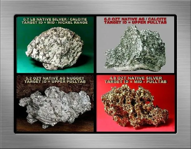

Some Background Information for Prospective Hobbyists
Native silver ranging up to 95% purity, acanthite, pyrargyrite and proustite ruby silvers, stephanite, and other collectable silver minerals primarily occur in carbonate veins in association with gangue minerals such as quartz, chlorite, fluorite, barite, albite, hematite, magnetite and many other minerals normally related to relatively shallow epithermal deposits. The native silver in this area is intimately associated with major cobalt-nickel arsenide deposits that include collectibles such as safflorite, cobaltite, nickeline, and skutterudite. These minerals will also produce target signals, and their localized mineralizations are an added constituent inherent to the area’s minesite substrates in addition to the usual variable strength magnetic susceptible iron minerals.
Attractively structured native silver in creamy white or other lighter-hued carbonates, or for example in association with other closely related silver minerals, notably for example acanthite and proustite, is highly valued by collectors. Structure refers to how the silver is formed, examples include massive or nuggety formations, plate, disseminate or particulate, sponge, highly crystalline, and various dendritic or branching patterns as depicted in the small example below. This sample was cleaned with a rotary tool silicon carbide bit, followed by a dish detergent wash and clean water rinse.
Silver ores and nuggets found in northeastern Ontario’s silverfields share a similar target ID range to gold, a result of variations in silver purity, type of mineral inclusions, size, shape, structure, and the influence of ground conditions.
Ground conditions normally refer to magnetic susceptibilities associated with various types of iron mineralizations, other localized minerals as noted above, and to substrate type and moisture content. The prevalence of both conductive and non-conductive iron-mineralized hotrocks, the abundance and proximity of rusty manmade iron to silver targets, and the effects of recently disturbed ground resulting from recent mining activity such as mechanized bulk sampling operations, also significantly impact metal detecting for silver ores. In short, do not trust target ID except over strong, obviously non-ferrous target ID signals, and even then larger iron will usually read as a highly conductive non-ferrous target.
The photo below depicts a silver specimen found with a Fisher F75 metal detector. It was operated in the motion all-metal mode that features an enabled target ID while doing some exploratory trenching at a roadside accessible, former high production site. Serious exploration, sampling, and excavation are fundamental to consistent recovery of specimen grade material. Trenching, scraping surface material, or sinking test holes is not for anyone but more determined hobbyists because repetitive digging in rocky substrates is hard work and time consuming. But one way or another, consistently finding worthwhile silver nowadays translates into a lot of digging.
The example below was cleaned with a rotary tool silicon carbide tip followed by a detergent wash and rinse. The photo doesn’t do justice to it, for example you are hard-pressed to discern a quarter-inch silver vein protruding in front by almost an inch. Three-dimensional effects are almost impossible to achieve when shooting from directly in front of the sample.

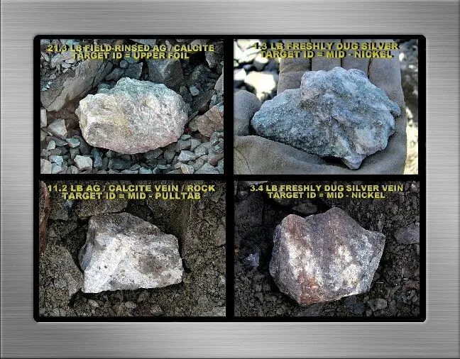

It is a daunting task to search an area that produces countless iron and other trash signals, especially if you contemplate removing some of the large iron residing close to the surface to improve the odds of finding previously masked, occasionally larger silver at depth. Obviously one does not undertake this task unless reasonably confident that such silver is present, and that requires some knowledge about a specific site. But at the same time, we try to keep in mind that just one large specimen-grade silver ore makes all the hard work worthwhile.
As an alternative to the usual surface scanning in already pounded areas, that will keep you permanently on your knees if you’re intent on clearing away some of the large iron, we sometimes resort to exploratory trenching as illustrated in the above photo. Where possible, we prefer to trench on sloping ground, utilizing gravity to more easily move material and recover targets. Trenching allows us to scan to considerably greater depths where the probability of detecting silver sharply improves when on productive ground. All encountered target signals are investigated and removed, hence there are no worries about iron masking or otherwise overlooking good silver.
There is more to say about identifying sites that at least warrant some limited exploratory trenching or digging selective test holes, or even scraping away surface material, but that discussion will be reserved pending a follow-up article entitled Trenching and Metal Detecting for Native Silver. The specimen grade silver below is just one of many fine examples we’ve found over the years using the above technique.
3.8 LB AG CALCITE SFYG18LOG.webp​
Despite searching in tough iron-abundant areas, we still prefer to search in the motion all-metal mode where we can benefit from either target ID or its equivalent in the MXT prospecting mode without the depth loss that accompanies discrimination modes when slowly scanning over variable rocky surfaces. Some prefer the MXT relic mode as an option to get the depth benefit of an all-metal mode combined with discrimination capability, but the incessant cacophony of mixed mode honking tones over target-rich ground does not agree with me… a personal preference and nothing more. But frankly, in most prospecting scenarios discrimination modes in any format are not a good idea. We much prefer motion all-metal modes for improved depth and sensitivity to targets and for evaluating ground conditions, and we also prefer unimpeded target-sizing ability to better assess what is happening beneath the searchcoil.
When searching in a motion all-metal mode, over questionable target signals we frequently make use of the auto or fastgrab GB (ground balance) feature available on many modern VLF prospecting-capable detectors. The auto GB feature supplies us with additional information about a target that obviously requires some interpretation based on your detecting experience in these field conditions, and that information can be used in conjunction with target ID and target-sizing when evaluating suspect signals.
In this area for example, a few F75 autograb coil pumps over most rusted iron… a manmade maghemite… that has leached into the immediate surrounding substrate normally lowers GB values from the high GB80s into the more conductive GB40s. This especially applies to small iron and other common items such as rail spikes and large nails. But occasional drill rods, tools, implements, and other larger iron may not react similarly or at all if located sufficiently close to the coil to produce a strong signal.
Non-conductive iron-mineralized positive hotrocks and our conductive pyrrhotite positive hotrocks will also produce variable and frequently steep GB reductions, although larger pyrrhotite will retain its signal similar to iron nails. Nickeline and cobalt minerals normally generate rather dramatic GB reductions, whereas native silver experiences little or no GB reduction as illustrated below. Compare the iron nail fastgrab readout to the silver fastgrab readout, keeping in mind that both produced an iron target ID.

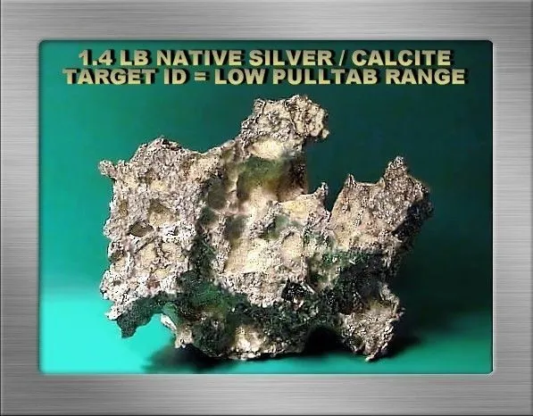

Hi William... just a word or three to thank you for your contributions here. I've enjoyed the exchange, while learning some basics about your multi-frequency unit. I do like what I've seen, but would probably get it initially with coin and relic hunting in mind. Of course it would get a good workout in the silverfields, just to see what it can do. But meanwhile we are content to meander along with our old but trusty units that have proven themselves in this application as illustrated below. That sample was found in the same trenching area described in Recreational Prospecting.
If there are any more questions about your experience with the White's V3i I'll be sure to contact you, and thankyou very much for your offer to help. :icon_thumleft:
Jim.
1.4 LB SPECIMEN SFDDD17PANNYGSH.webp​
Hello Jim...
That is a beauty... Nothing like that in my neck of the woods, unfortunately.

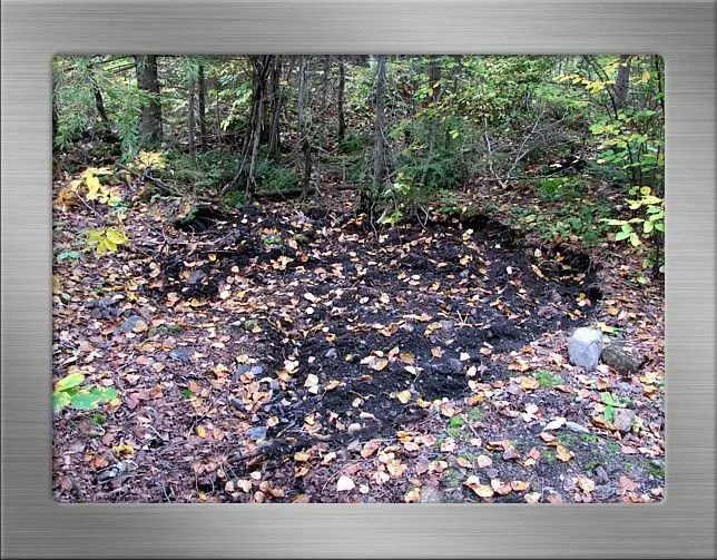

Well thanks Takoda… how the heck are you? I couldn’t fight back a smile when I read your comments. Never considered myself much above Neanderthal, but geez… coming from you “scholarly” sounds pretty good. Thanks for taking a moment to post those nice comments quoted above. Truth is that I usually don’t really know what to write until my fingers start moving on the keyboard, so I’m pleased that you seemed to enjoy the read.
We had a really nice autumn in the northeastern Ontario woods, exploring and sampling, kicking rocks and digging all over the place… and somehow we managed to find some silver. Surface detecting… at least with my equipment, which isn’t very deepseeking… usually means slim pickings nowadays, so we’ve resorted to lot of digging where our sampling results offer a glimmer of hope.
Hiking the outskirts of an abandoned mining camp one afternoon, I happened across a small area that a determined rockhunter had sampled by removing roughly the top foot of surface material. I took the photo below because his work illustrates exactly what is required. The entire sampling project probably required a full afternoon to complete. There was nothing to suggest deep silver was recovered at this site, at least no evidence of deep holes… but dimes to doughnuts says that with persistence this individual is bound to hit paydirt.
COLEMAN SCRAPINGS SFKE.webp​
Experienced hobbyists in our area will recognize that even encouraging sampling results are frequently misleading, and the subsurface proves to be unproductive. This is par for the course in this business. But if we can locate one productive site during the autumn season, in our experience the results justify the effort. Often enough the sites where trenching proves disappointing will still usually produce an occasional stray silver ore or nugget.
And we don’t feel that we have to find large silver. Comparatively small native silver as depicted below typically is the richest, or is the best character silver that we have in our collection. Just a sample or two each day over an autumn trip of six to eight weeks will pretty much fill an orebag… and that is plenty good enough for me.
20161129_150221.webp​

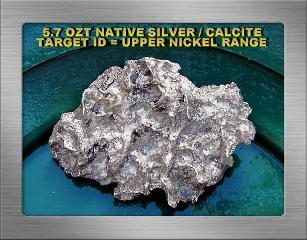

Below is a silver specimen we detected in the trenching area described in Recreational Prospecting the previous autumn. I think readers will understand why we returned to the area the following year with trenching in mind.

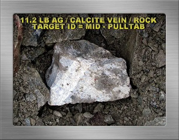

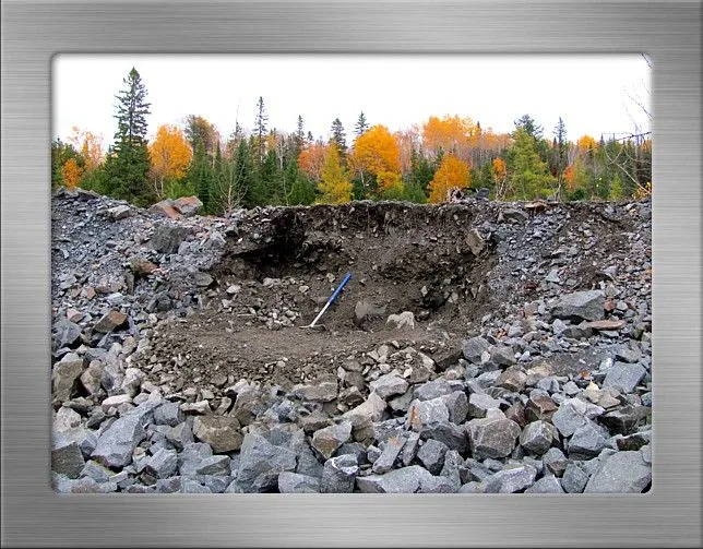

Hi John… thankyou for dropping around and for posting those nice comments above. You are certainly no stranger to me because I enthusiastically follow your posts to the Detector-Prospector forum with lots of interest. I enjoy viewing your ruggedly beautiful scenery shots in addition to the numerous photos you employ to describe your field conditions. I hope you’ll continue to share your prospecting experiences and I’m sure that everyone who reads your material appreciates your contributions.
You’ve been doing really well with the GPZ7K. It is amazing to see the quantities of small gold that you have found using that machine. I read your recent story about having to use the Goldbug2 instead of the GPZ7K in that gully. Apparently you forgot a battery or accessory for the 7K… whatever… and couldn’t use it. But I enjoyed reading about the quantities of small gold that you found using the Goldbug2. That experience as you related it illustrates once again that first and foremost we can attribute successful gold hunting to the operator… since no detector can find gold by itself. It was a meaningful story with a lesson behind it, so thanks for sharing it with everyone.

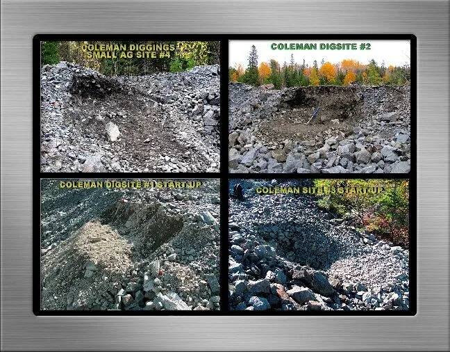

Getting back to this silver thread for a moment, two photos below. One is a start-up digsite where we spent a few afternoons digging and eventually detecting the rock with vein material cutting through it as depicted in the second photo. I washed the rock prior to the photo to make the vein more visible. It is labeled as silver although there is no visible silver evident and won’t be until it is treated, and the weight is misleading insofar as I’m sure the actual vein material weighs no more than three or four pounds at most. There was no time to clean and include this rock into the Recreational Prospecting article.
All the very best to you and the family in the forthcoming year John… please keep writing about your adventures and maybe even post a few to this forum if possible. Good luck and take care. :)
Jim.
11.2 LB AG CALCITE VEIN SF18YYG.webp​

I was into Cart Lake briefly to snoop around the old headframe depicted below as it formerly appeared. Now it looks about ready to fall over, so I hope they’re going to restore it for the sake of the Silver Heritage Trail. A few small areas had been scraped down several inches with a dozer, so I scanned a section along the upper entrance with the F75 for an hour before it got dark. That produced a few small non-descript pieces including the one below, and no junk signals which was nice. It was heavier than all the others combined… reminded me of years ago when such material was fairly commonplace there. It’s not solid silver by any stretch, but still a nice surprise. It goes to show that you just never know what you’ll detect over fresh surfaces.
Jim.
1.2 OZT NUGGET SF17YGPANO.webp​

Thanks Greig, it isn’t much fun working on those rocks out in the patio on a typically cold November evening, especially since there’s a fan going full tilt to blow away the rock dust. We stick to samples that will suitably illustrate an article and leave the rest for the following spring. You might notice that my photos are either straight silver or silver in calcite because they look much better than silver in grey country rock. We sometimes find larger, rich samples embedded in such grey rock, but they don’t make an attractive photo.
Sampling can be improved using deeperseeking equipment than mine, but it will still involve some elbow grease to move surface material out of the way. Surface sampling, if indicators can be found, sometimes point to what lies below, but there are no guarantees. It really is a hit and miss proposition… par for the course as you know. I don’t know of any systematic alternative method to locate inadvertent silver dumps that occurred frequently back in the day.
Below are two multi-photos showing some digsites from this past autumn and some rocks pre-rinsed prior to the photo. Three rocks are self-evident whereas most of the silver occupies the bottom three inches of the twenty-one lber. So that total weight is quite misleading once you examine the rock. It will require some serious work but after treatment it might weigh in around five or six lbs… elongated, probably six inches wide and three inches thick. The lower layer is replete with leafy or dendritic silver, soft and high purity. I intend to employ repetitive acid baths to expose it embedded in that calcite matrix. I may come back to this thread later in the year and post a treated sample photo… but first we’ll have to see how things turn out. :)
Jim.
20161130_013310.webp​
