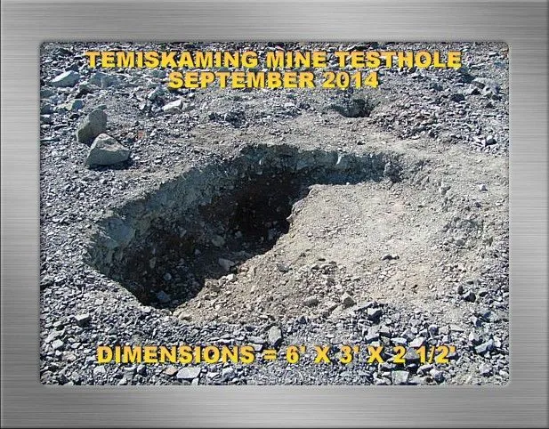

The photo below depicts what we refer to as a testhole. This one was located up above the ridge and over on the Temiskaming site. It produced some quality small silver and lots of nickeline as Cryptic can attest. I thought that specific area looked promising, but at that time I wasn’t physically able to continue with it. We eventually learned that spot is known to locals as the “Silver House” and produced a lot of good surface silver.
Jim.
TEMISKAMING TESTHOLE 2014.webp​

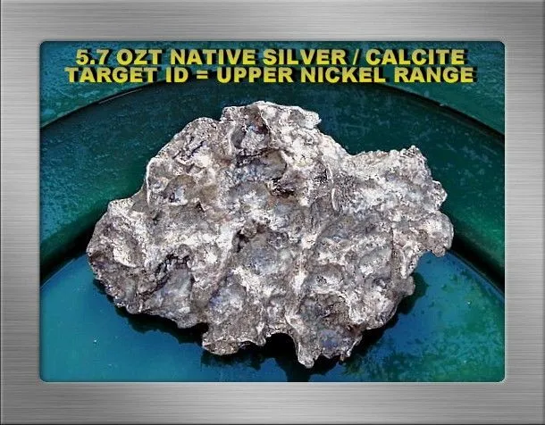

Below is a silver specimen we detected in the trenching area described in Recreational Prospecting the previous autumn. I think readers will understand why we returned to the area the following year with trenching in mind.
Jim.
