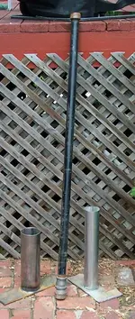

You may like one of these easy to make rock crushers..........
http://www.treasurenet.com/forums/gold-prospecting/188969-portable-rock-crusher.html#post1980956
Here is my 3" and my 4" made from scrap exhaust tubing and 1/4" steel plate..........
For the ramrod Harbor Freight sells a nice 17 Lb. Posthole Digging Bar with Tamper that would work great.
