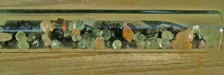

Here's a photo for Ian on my first "golf ball" Garnet polishing experiment years ago. The Garnets, mixed with other stones now in the photo, were "Golf ball" sized when I started :laughing9:
