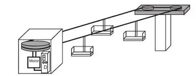

Hey guys I've been doing a lot of research and I found some photos from the 1930's for my area. It appears as though they were actually using a pulley system to move buckets of material off the hillside. I've been wondering about this, since it seems to me the best gold is up there. I'm not really sure why everyone mines in the river...maybe since it's easy? Anyways, I have a friend coming for the weekend and I thought it would be really fun to build a pulley system to move dirt down to the river. I was thinking one of us would fill buckets while the other fed the sluice. Obviously, this is not a simple endeavor and I don't even know if there's a crazy law about it, but who knows anymore. Anyways, do you guys think it's possible and/or worthwhile? I'm guessing it would take a lot more work than if I were to just carry the buckets of dirt, but that's not as fun. pulley.webp

Pulley on both ends, 2 buckets. Fill up a bucket up top and let it go, the empty bucket at the bottom comes right up to the top.

I'd set it up with 2 parallel zip lines with a bucket on each and a line running thru a pulley on top. When the full bucket goes down it pulls the empty bucket back up. Fill-empty-repeat. Twice the productivity with no wasted time bucket fishing or manually retrieving with an attached line.

It's not simply rope and pulleys, it's 1/2" cable or larger in the picture, stretched tight. And even then, it will still sag with a full bucket if not winched down correctly. That set up took a lot of engineering :)
I would think with the amount of engineering, trial-and-error, equipment, etc., necessary to get a bucket and pulley system operational, you'd be better off (and money ahead) to use a drywasher at the site.
