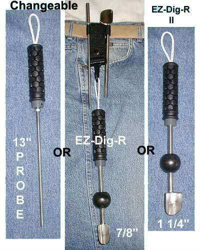

Here is what I use and I have recovered targets and coins over 8 inches deep with it, when I am done you can never tell I was there, there is no plug so there is never any dead grass. I cut a slit only in the grass and pinch it back together when I finish... Granted it takes longer than using a shovel, but you would be surprised how fast it is. I have had park employess stand and watch me then turn away with out saying a word as I leave no visible sign I was ever there....
Tom_in_CA , I don't know how this screwdriver tool thing got started . But they have the same rule at a larger state park near me .
Treasure_Hunter , those tools are really unique . Can I ask where to get some please . I've never seen anything like that before .
Sorry, they are no longer made, you will have to make your own..... Point I am making is you can recover small targets using screw drivers and tiny diggers. I use the DetectorPro Uniprobe pinpointer, I can locate the exact location of target with it, I then use the metal probe to get the depth, then I recover it with the small digger.......
