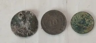

My today finds:
I have a lot of questions:
I get in a couple of times signal 80, next second 5,6, next 79, next 5,.. In same place, can anyone explain me why?
And, i dig some holes where i have good audio and number 50-60, but in hole dont have nothing. Can anyone explain me why?
My today finds:
