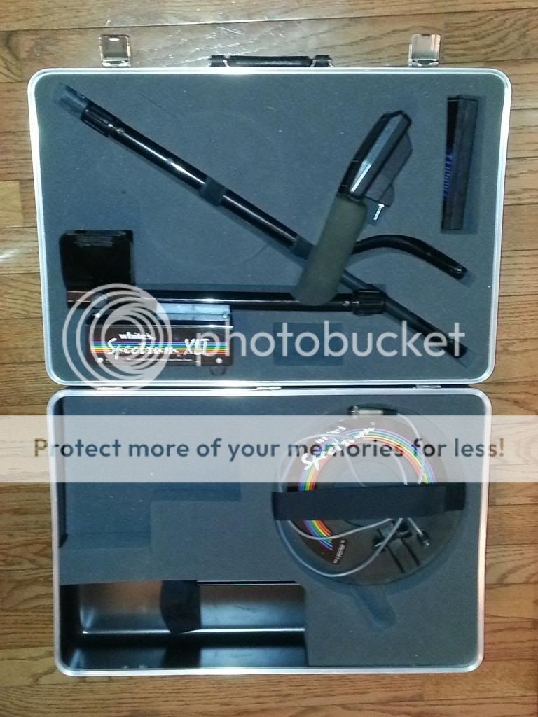

Well I scooped this puppy up and I have been looking at all the customization you can do and I am blown away! Looks like a sweet machine and seems to be balanced very good! I will post some pictures in a little while.
Here she is, there is two battery packs and headphones too. Thanks for all the tips guys, the meter illumination works and the coil only has a few scratches no scuffs.
NICE BUY !!!!!!!!
Thanks! cant wait to start detecting with this thing!
