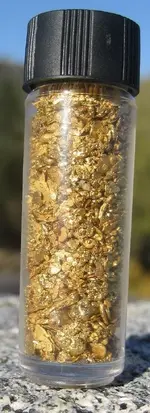

I did a lot of research and I think I got the idea from someone on this forum who said they just got their sluice in the mail and described a hole pattern like this. The middle tube staggered with 1/8" holes along the center and the outside tubes had holes on half inch centers about the 45 degree angle downwards. Almost every part of this sluice has been taken from different places. I think I have as much fun with DIY projects like the sluice and dry-washer as I do finding gold itself ............. but there is nothing like topping off your first ounce!
