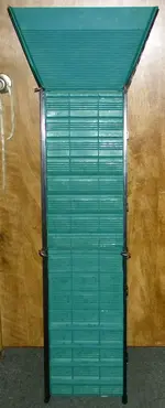

kitchen prospector.webpi got this little pocket sluice off the auction site.so i made a little kitchen sincker for when i cant sleep and just want to run some cons! lol
P1000932.webpIt's an evolution.
I had to add the next generation.

Right off the bat I'd have to guess that is a tad larger than most of the sluices used by the majority of the members here. :tongue3:
Here are a few shots of my humble little sluice I made up from scrap that was on hand in the shop.
In the shop ready for finishing :hello2:
Close up of the header box. You can't see it in the picture but there is a shelf under the screen that directs the slurry towards the front of the box. Inside of header and main box dyed black to help gold show up. :headbang:
Up and running. Still need to increase the water capacity for both water available and the amount it moves through the system. Currently it's pumping just under 2000 GPH. I will also be lightening it up with a new stand made from PVC pipe and fittings. :BangHead:

Here is my BGT Prospector and the couple of mods to it. Ignore the hardware cloth as the jury never came back. My hope was that it would act as a nugget trap (that visual thing again). However I'm going to remove it as I would be better off taking a piece twice as wide and attaching it at the top end to aid in the breaking up of clay balls. Second mod. is the legs. I tend to pack way in so I try to keep everything as light and compact as possible. I didn't want to carry or assemble a stand and getting rocks stacked right and stable to support the whole sluice was miserable. Originally I had them on the front as well but that made it so I couldn't dump it into a bucket. So this is the compromise. There is always a rock available to support the front, and I can dump it easily, fine tune and anchor the sluice.

Got in some goodies and added to my 12x36 sluice. Put in a 1/8" perf plate going to a 1/4" perf plate that goes to a 1/2" expanded metal. Hoping to test this out this weekend if there is a good enough water flow.

Having the scoop guiding water to the lower chamber may be a mistake as it will increase pressure thru the tubes and that may blow fine gold out of here trap. Something to keep a eye on.

My sluice isn't anything special. Top 4' is yellow cedar which is nice to work with. I run hog mat the full length. The part I am really proud of is the hopper. P1040094.webp
