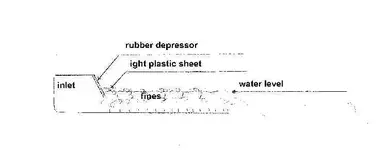

Gentlemen: A thingy that I did up at the mine on the tables, was to simply float a piece of light plastic on top of the water, the full width and length of the sluice / box in this case. It forces the fines under the surface leading to very increased recovery. The origional rubber sweeper at the top does not do this efficiently. The additional fine recovery alone, paid for this part of the operation.
Don Jose de La Mancha
