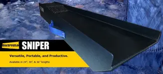

Used to own metal riffle sluices. Sold em. Still own a plastic drip riffle for occasional use (not in the last many months, should probably sell it!), actively using a Bazooka Goldtrap Prospector and Sniper. Getting 2-3x the gold is a solid argument for the Bazookas BUT they cost a lot more than a homemade drop riffle which will give you a great start. The thing is, for those who can afford it and can get out regularly, catching more gold WILL pay for top quality gear...no doubt!
Just started myself! I grabbed a 24" Brawn sluice with the louvre riffles at Cabelas for $70 to begin with and had decent luck with it. Being straight and short, it was kind of a pain to set up and running material through it was slow to say the least. I ordered a 36" Bazooka Sniper and I'm very happy with it so far. Much easier to get situated in the creek and doesn't bottleneck the process at all. 10/10 would recommend.
Here is the Brawn:
Here is the Bazooka:
