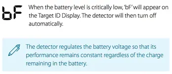

just leave it on....it should run down and shut off when empty...this is a safe option according to the manual. the equinox is protected from over discharge and will not harm the battery.
Screen Shot 2018-05-22 at 11.12.58 AM.webp​
