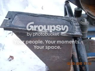

My friend made one for me.Worked very well,but somewhat slow.The model shown could use some modifications.Mine used a number 60 chain and the last link eventually wore off,which is no big deal.A zig-zag shoot on top would be much better for dust control and rock throwback.Having a screw type device on the bottom to push out all the fines into a bluebowl or sluice would work wonders.Will try and get up pictures at some point.I used a wet/dry vac to clean out the unit after unbolting the side plate.Slow and annoying.......
these pics were courtesy of a fellow on the old Alaska gold forum,the secomd pic shows the guts which are likely much better than using a chain to pulverize the rock.
..showing the number 60 chain inside.On this unit you had to vacumn out the crushed material after removing the plate.Not very efficient but it works.The motor is from a washing machine.If your handy you could probably build a unit for $100 or less if you've access to the materials.You can make it any size you desire.
Damn that is a lot simpler than I imagined. Thanks Dave. I think a person could probably either weld hard steel to the chain shackle, make a hard steel hammer or hardface it for better wear. Time to visit the scrap yard maybe. It will probably be June before I can get back to the mine but I have a few buckets of ore to play with. I am definately not going to crush it by hand. What rpm does it spin?
Mirkaba,wouldn't know about the RPM's as I'm not mechanical at all.Mine in the lower pics was run like I mentioned by an old washing machine motor,either 1/2 or 1/3 HP.People have old washers/and or dryers laying around and mine was free.The unit I had tore the quartz to hell.Very fine powder but don't know the mesh.The body was made from some type of old holding tank and cut down.On the plate that opens it's wise to have a gasket as some dust will fly out.Even if you have to replace the shackles now and then it's worth it.I gave my unit to a friend who worked on my truck as my mining partner didn't like that the recovered gold came out in little BB like balls,ha.ha.The fellow recovered a DWT of little BB's from the dust inside.Like mentioned earlier if you can figure out a shoot on the bottom emptying into a classifier that would be great.
