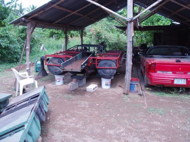

Started My 6" Build
Drop riffle in a dredge would be kind of cool...not sure how well it would work with deeper water and big rocks.
It would have to have a screen above it to keep the bigger stuff out. I've been toying with using one in the 3" I'm building for my son.
I was just thinking. I'm wanting to put dove tail riffles like Reed has in his box...I bet those almost act like drop riffles. What do you guys think.

Is your box going to be fixed or adjustable? If adjustable, what method are you looking at?
Get that box uptop and adjust angle by moving forward and back for balance. ALWAYS keep the exit from being underwater. Same barrel rack design I used on my 6-8 back in 88,but 55 gallon and it was a much bigger dredge. Extremely safe in fast water -John
Its going to be adjustable just like in these pics.
I'm going to use a winch on the rear, slide on front and chain on the front.
Getting close to being done with the frame.

Getting close to being done with the frame. <img src="http://www.treasurenet.com/forums/attachment.php?attachmentid=952964"/> <img src="http://www.treasurenet.com/forums/attachment.php?attachmentid=952965"/> <img src="http://www.treasurenet.com/forums/attachment.php?attachmentid=952966"/> You can see my $75 camper I bought yesterday. Although I love camping, after awhile it gets old...
Looks like you have a nice job going on there .. Hope to hear some results from you todays on how the jet is working.. We finally got some rain today after like 5 months.. Never been so happy for water.
Thanks bill, I first I wasn't real enthused about the barrels or the size but have came around. I realized that if I ever was in a situation were I could use a 8" dredge, the floats and frame would be good to go!
