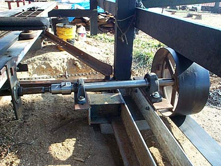

I think that is the idler bearing from the unpowered end of a shaft. The axle goes through the hole in the cover and rests on the two wheels.
Just about the center of this image is a similar one. This is a small sawmill driven with a tractor PTO belt.
Yes that makes more sense than a rope, an axle or shaft goes through it but I dont think it was greased and I dont think it would have turned much as there would be wear on that upper part..
