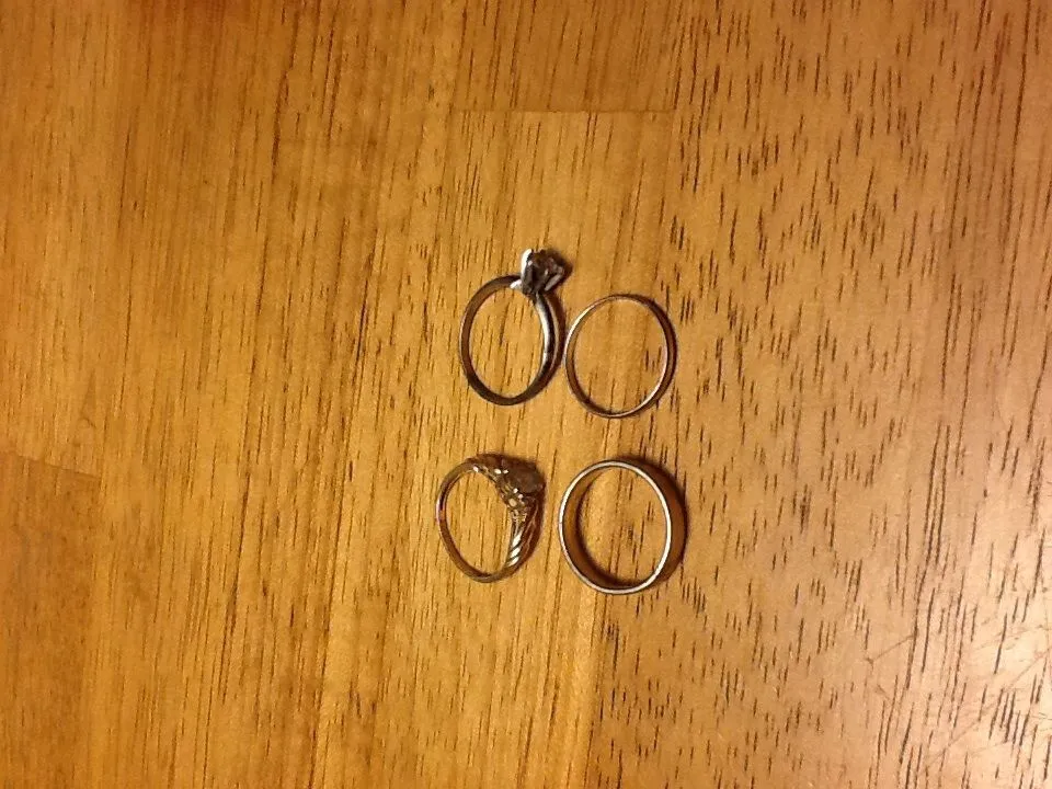

I just got a tesaro sand shark and have only been on 8 hunts with. I started with a vibra tector 730 for 150.00 and with the platinum ring and two gold I found made me want to go to a full sice PI machine. Found the sand shark used on ebay for 400.00. I have already found 4 gold rings with it. I like it a lot. It has two dif sound settings and runs with a constant hum that you can adjust called thresh hold. I snorkel detect w a regular scoop :) three rings 14K one ring 10K almost didn't dig the small one but I DID ! One was in the scoop w a bottle top. image.webp
