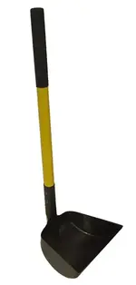

So the prospector n00b in me see's a tool for scooping light overburden but the forum pro in me says that you think my posts are pooper scooper worthy Crap. :P
Just not sure which, but if strong enough that would be a nice scoop. :D

That's why I suggest the bucketdigger style. Take scoops like a excavator, pulling the bucket towards you.

Where would I buy a scoop like the first yellow handled one that you linked?

Click on 'bucketdigger' in my prior post. They also advertise in the gold magazines. Looking on the website, it's fairly short handled. I'd build one with a 6-10 pole.
If you're just moving sand, maybe you'll have some luck blowing it away.
