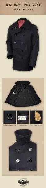

I may be a day late and a dollar short on my arrival here, but I thought I'd add my 2-cents worth anyway. When I was scrolling down the "What Is It?" topics for a new thread to haunt, the first thing that caught my eye about this one was the 4833 views it has received. I read through the various comments the best I could, but admit I may have missed a key clue or two. But one thing I did notice, and was surprised about, is that not one picture of a real pea coat had been posted for comparison. And that's when I started my personal search to find out exactly what one looked like that was in good shape and not deterioating. The result of my search lead me to the website below that I have provided a link to. From it I found the pea coat pictured, which I just grabbed at random as an example, but it is not intended to suggest that it is exactly like yours, but rather to draw attention to the website itself which shows approximately 80 different pea coats. I haven't even looked at all of them myself yet, as I am not familiar enough with your particular coat to make an educated evaluation. But since you have the coat, I thought that you might. If you use the site, make special note of the various worded descriptions. In one of them their may be a clue that will help.
For example, in the description of the 1960s pea coat below, and various others from that era, it mentions ....
"Corduroy Lined Pockets"
When they started lining the pockets with corduroy, and for how long, I do not know. But it might be a place to start and check your coat to see if it was made this way. And please let us know what you come up with ... that is, corduroy lined or not? And from there we can go to phase two if necessary. But please don't ask me what phase two is, because I haven't gotten that far myself yet. Lol :dontknow:

Basic description of coat pictured below:
[ 1960s vintage pea coat with original tag and corduroy lined pockets ]
(With "corduroy lined pockets" being the emphasis of my over-worded post).
SJJ ~
This is not exactly what I think of as true corduroy ... but it is an example of the type of lining they are referring to on the website I posted. I'm still not sure when this design feature began, but it was definitely being used during the 1960s and 1970s ... at least according to that website it was. :dontknow:
But the main thing is to determine if your coat has it, or traces of it, and then go from there.

Correction ...
I went back to the website I posted and found several examples of corduroy lined pea coat pockets from ...
"The 1940s"
I have yet to find one earlier than this or later than the 1970s. But I will continue to look. It takes a lot of time to open all 80 of the pictures/descriptions.
SBB
Until I hear from SJJ about the pockets, this will conclude my present research. I was able to determine that the pocket lining was in fact a "true corduroy fabric," and not a silk-type. The last picture I posted actually shows it, but it's a little difficult to make out clearly. It is referred to as ... "U.S. Military Correct Spect Corduroy."
Although not conclusive by any means, I have been unable to find a single reference for "corduroy lined pockets" any later than the 1970s. Nor one earlier than the 1940s. So until something arises to refute this, we have a relatively safe date range of ...
~ 1940 thru 1970 ~
( Providing, of course, that SJJ's coat even has corduroy pockets ).
