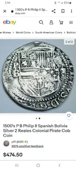

But I'm more confused about the coin. The authenticity letter said it was a one real cob minted in Barcelona. The coin guy told me it was a 4 reale.?
After getting home I see a P next to shield on reverse. Wouldn't that mean it was minted in Potosi, Bolivia? I don't know anything about cobs and like to know exactly what we have. I'm wondering if the authenticity letter was not for this coin?

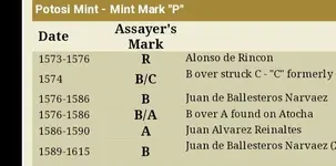

I'm not very impressed with my coin dealer that he thought it was a 4 real. No where close on dimensions and weight. It does meet 2 real. 22mm. Weight is less, 6.2g, but maybe that is because of damage or erosion? Also the Bolivian mint was a P before using that dollar sign symbol. And I've found several Bolivian coins that look exactly the same. P upper left and I guess assayer letter below.?

Juan de Ballesteros Narvaez is the assayer if i am not mistaken.
B = Ballesteros

1615 I think, like 2nd or 3rd period. We did a discussion on these cobs last year, and yes its from Potosi.
