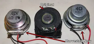

Build your own with WS4 speakers, it's cheaper and there is no compromise in sound (see my DIY thread).
Ditto that 462. Just finished a set of Home Depot Muffs similar to yours. Work great and sound better. I opted to use some PC speakers instead of the WS4's.
After that I hacked my Gray Ghost's and now will use those as they sound just as good as the WS4's but feel super comfortable.

Awesome job on all the phones that I've seen. I am still not sure how you all notched the headphones to accommodate the adapter, but I am sure that it isn't too complicated.
On my 3M headset, I just strategically hot glued the original WS4 adapter on to the side of the plastic case. The Gray Ghost's use three screws and a pile of hot glue on the back to make sure it doesn't strip out.
-Tim
I marked the hole locations with a scribe then used a drill to start from and then a Dremel Tool to open the hole up and make a slot. I made the slots one at a time and slowly opened them up until tab dropped in. On mine the tabs don't actually lock the adapter in place but they do add some stability. The screw is what hold the adapter in place and I also put some epoxy in the holes to make it more secure.
You can see in this picture the holes for the tabs are a little over-sized, I just filled that in with epoxy after I made sure everything was were I wanted it and working.
Thanks. I have an older set of modified Killer Bees that I am going to cut slots into to accommodate the adapter.
One other thing I did was cut down the posts behind the tabs some, so the adapter sits closer to the ear cup. You just need to make sure you leave enough clearance to allow the puck to slide on.
