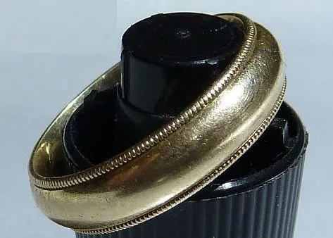

Once I was at the end of a hunt moving way too fast around a large field sweeping that coil super fast too like a hockey player going down the ice on a fast break...you would have laughed if you saw me.
I was looking for one final good target, a "Hail Mary" target I call that, just hoping to get lucky and that time I did.
My vac was not supertuned, sense was probably about 8 and the disc was just below nickel and there was not a lot of trash in this area so I was just listening for any tone and I got a quick, short one even at the speed I was moving.
I stopped and went back to examine this target and it disced out right at the top of the tab level.
I dug it anyway and about 5-6" deep at the exact center of a 5" diameter hole I dug was a beaver tail tab laying flat.
I ran my Propointer around the hole before I closed it up and got another signal about 2" deep about 1/2' into the sidewall of the hole.
I dug out this target which happened to be a beautiful 14k woman's wedding band that in air testing disced out just under the 3:00 position, zinc.
Even at melt that one ring paid for the entire price of that big coil, and to this day I am convinced if I wasn't running with the Vaq that day and it's speed AND using that big coil with the long scanning field I probably would never have acquired that target or heard anything to make me stop and go back.
The possibility is there that it could have happened with the concentric, but the big DD coil and its one foot long scanning field made it a certainty.
