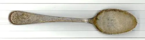

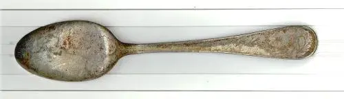

Very old Flower decorated spoon.

Michelle said:
Good try Michelle, I had looked at souvenir spoons. I think its a very old table ware pattern, but I have no clue.
The only writing on it is "silveriod" Then just some type of flower...I don't see it under any of the Silver Plate manufacturers. I really need to find out more about it..Thanks!

"Silveroid" is one of the generic trade names (Silverite, Silverine, et al.) for nickel silver or German silver— i.e., a non-silver, white metal alloy. This mark is often seen on watch cases as well as flatware. However, I don't believe that it has been ascribed to any particular maker. "National Silveroid" is a British mark. The similar "Silveroin" was a mark of the Bristol Mfg. Co. of Attleboro, MA. A "Silveroid" fork with an ornate floral pattern, front and back, is listed on eBay, but the seller seems to have little information about its age and origin: http://cgi.ebay.com/Small-Silveroid-Dinner-Fork_W0QQitemZ7338284604

Good hunting, but I still cant pin down a age range. The seller says perhaps CW, but thats a guess. I do believe that is a match for the spoon.. At least we know there is another like it. Thanks guys!!!!

I think it's probably c. 1890-1910. There was a boom in cheap silverplate and nickel-silver tableware at that time. The pattern looks as if it might be of the period, too. In addition to Silveroid, Silverite, Silverine, Silveroin, and German silver, there were a lot of other exotic names: Burmaroid, Argenline, and all of the following with the word "Silver" after— Aluminum, Nevada, Montana, Japanese, Indian, Panama, Brazilian, Australian, Norwegian. Many of these were made by the firm of Daniel & Arter (a.k.a. Globe Nevada Silver Works) of Birmingham, England.

I found this reference:
An alloy was developed specifically to meet the needs of the American pocket watch case that answer the question of durably and affordability. This combination of 45% nickel, 54% copper and 1% manganese was called silveroid, silverore, silverode or silverine. It was easy to polish, very hard and looked just like coin silver.
http://www.silverjewelryinfo.com/0704_silverwatchcases.html
