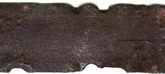

"Viking" swords were generally made of a soft iron core that was more springy-bendy-malleable, not as liable to break but the edge was harder steel which in many cases was imported. steel was valuable at the time so they didn't want to use too much of it. many axes and swords have been shown to have been re-edged when the good hard steel was worn through. Viking age thrift at it's best!
a simple set of tests could find out the source of the iron.
Viking age iron, especially the early stuff, was usually what is referred to as "bog iron". the iron was smelted from the rust coming up in the peat bogs of Denmark and Sweden as they didn't have any good access or hadn't found at that time the iron deposits in Norway. the bog iron was pretty crumby stuff, but it worked well enough when paired with some more expensive steel laminated along the edge.
the celts of Scotland made many of their swords the same general way, cheap iron in the middle, expensive steel on the edge.
in the picture I've attached you can see the line where the 2 metals are joined together quite clearly. this is an celtic example but shows the same general techniques as used by the Vikings in their sword production.

Sometimes the steel was crap, and sometimes it was actually very good. They may (probably) have acquired the very good steel from outside sources as you noted, possibly in what's now Russia. That was the story everywhere though. When you're refining, forging, and heat treating by eye, there will be some lemons. The early problems with the Springfield rifle are a more modern example of why the eyeball is not entirely reliable for this sort of thing.
What they were certainly not doing (by the time that we're discussing here) was making swords out of iron. Steel was the norm. You'd be better off with a club than an iron sword at that point. This is not to say that there were no iron weapons in circulation, but it would have been extremely unusual. Of course, had the broken sword in question been a piece of crap, the owner would have been less likely to have looked for the missing piece for recycling purposes...or would he? This was unknown territory after all, and even basic iron might not have been easy to come by.
