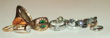

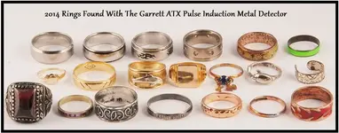

If you Google Garrett ATX Metal Detecting Forum you will find lots of information. Having said that, I am on my 2nd season using it. I use it for water hunting and relic hunting in the summer and fall. I also use it in the snow to search for lost coins from people sledding on hills.
In a nutshell, it is a PI metal detector, getting some of the best depth in the industry, especially in highly mineralized soil. It does not have discrimination like a vlf metal detector. What it does have is a low-high signal for copper and silver, and a high-low signal for gold. Iron and read in both audio tones. It was designed to find gold nuggets in very high mineralized soils. It is water proof. I use mine in hunted out beaches on land and water. In the woods for relic hunting, I only did low-high signals, searching for silver or copper targets. It has modulated audio ( deeper targets are not as loud as shallow ones) and also has a non-motion mode which gets even better depth then the motion mode. You can check my You-Tube videos to hear the audio on some hunts with it.
https://www.youtube.com/channel/UC8CORF4dsmopibINy0fWzGA
