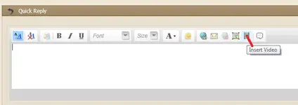

Start the video in Youtube. Coping the URL address of the video as seen in the second photo. (highlight the URL and right click on the highlighted URL then click copy) Then bring up your page on T Net. Click on the Icon that looks like a film strip enter the URL and click save. It will say insert video.

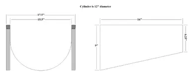

I met up with Garrett this morning. Did not know he had the chute with him. Thanks again. I will have to weld another 1 sq. tube just below the top rails on each side to make it work as chute is not deep enough but I will make it work...
Jay it looks good. When do you plan to put the wash plant to use? I met up with Garrett this morning. Did not know he had the chute with him. Thanks again. I will have to weld another 1 sq. tube just below the top rails on each side to make it work as chute is not deep enough but I will make it work...
Did the chute fit?
i was thinkin it was gonna be too deep
The chute fit from side to side but would but did not fit on the top rail as the center of the chute hits the cylinder. The idea is to keep the water from slinging out.
chute.webpChute11.webp​
The chute fit from side to side but would but did not fit on the top rail as the center of the chute hits the cylinder. The idea is to keep the water from slinging out. <img src="http://www.treasurenet.com/forums/attachment.php?attachmentid=916218"/><img src="http://www.treasurenet.com/forums/attachment.php?attachmentid=916219"/>
So my flat was wrong. Bummer. How much do you think is missing?
