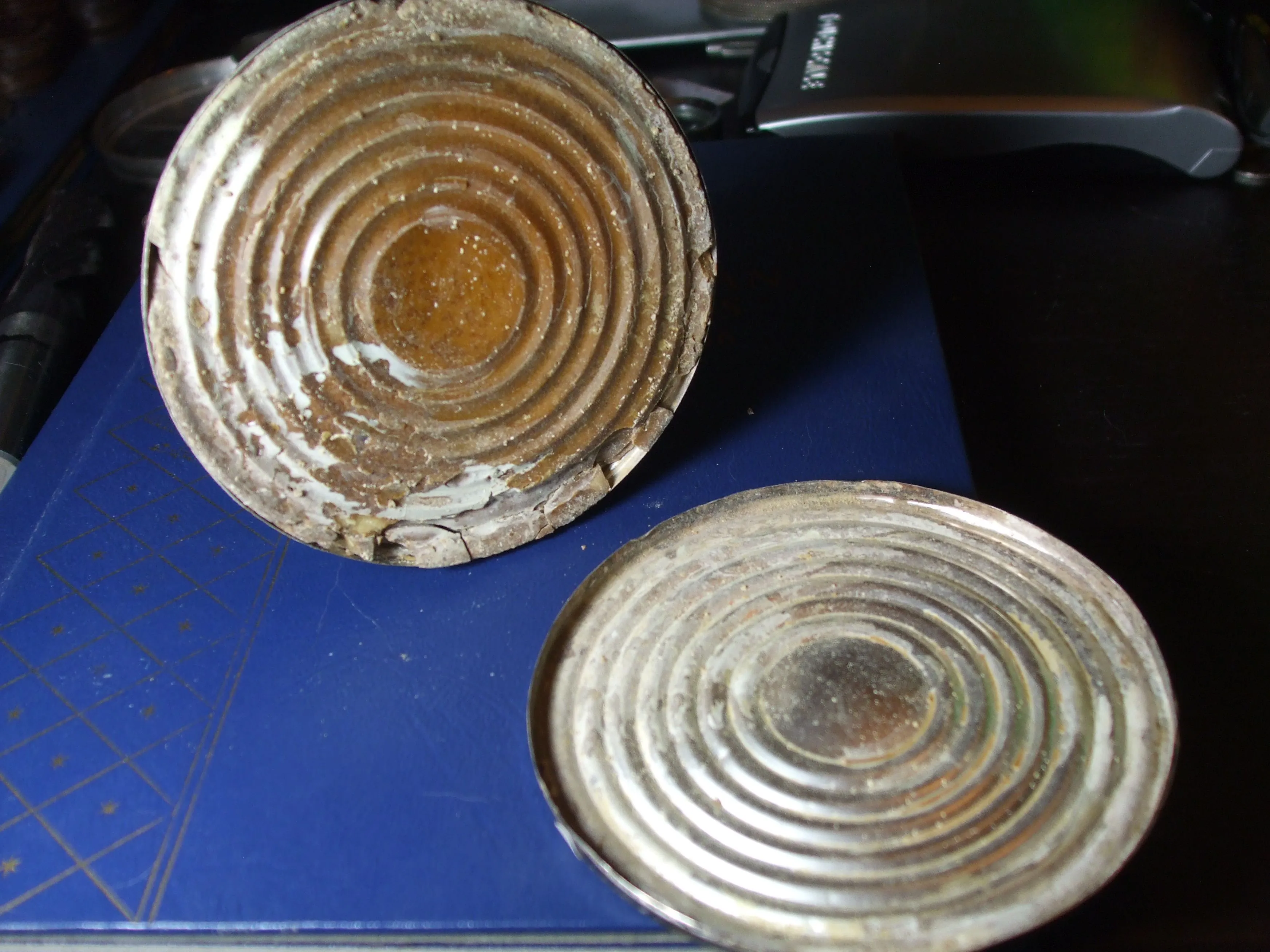

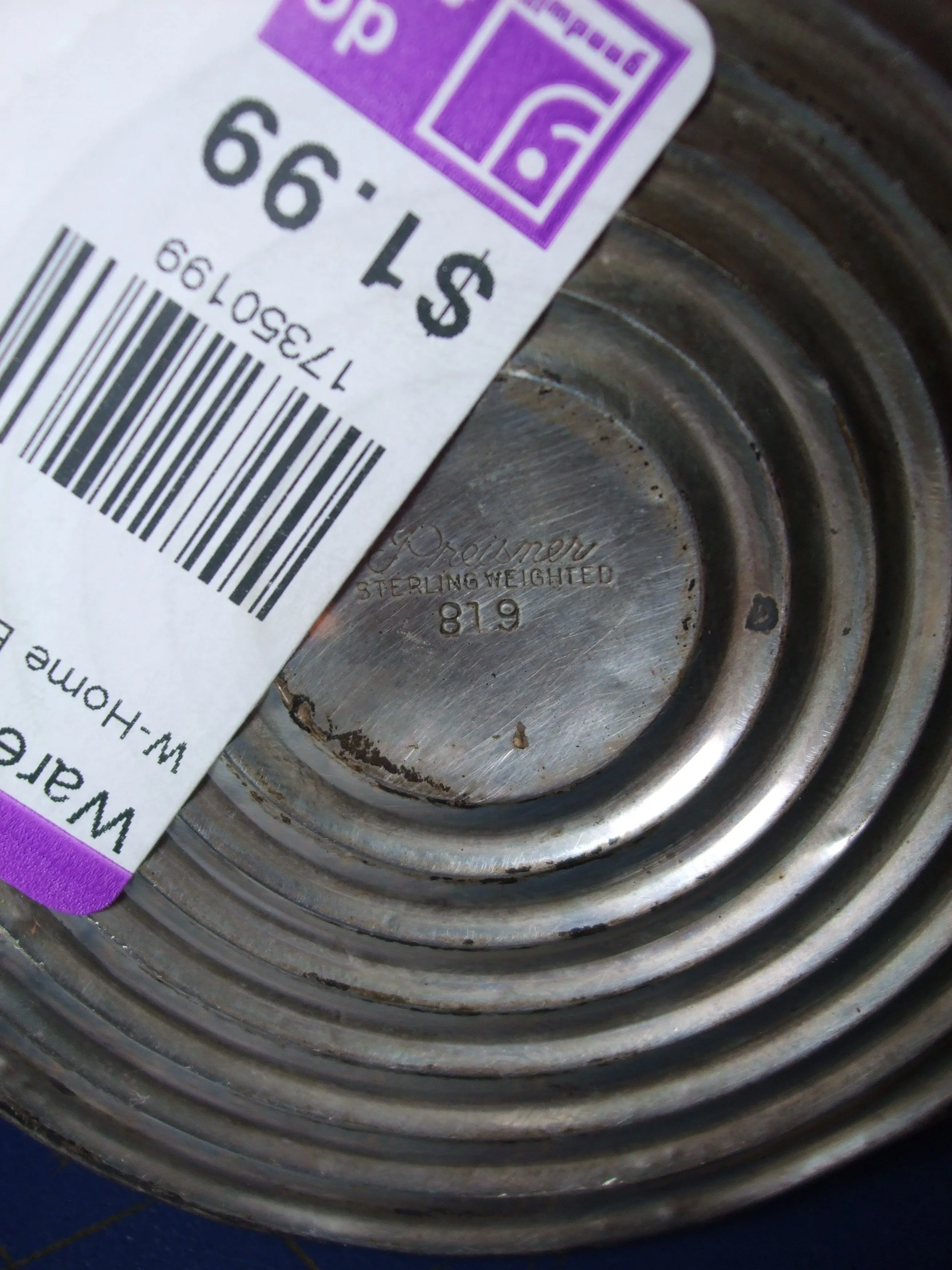

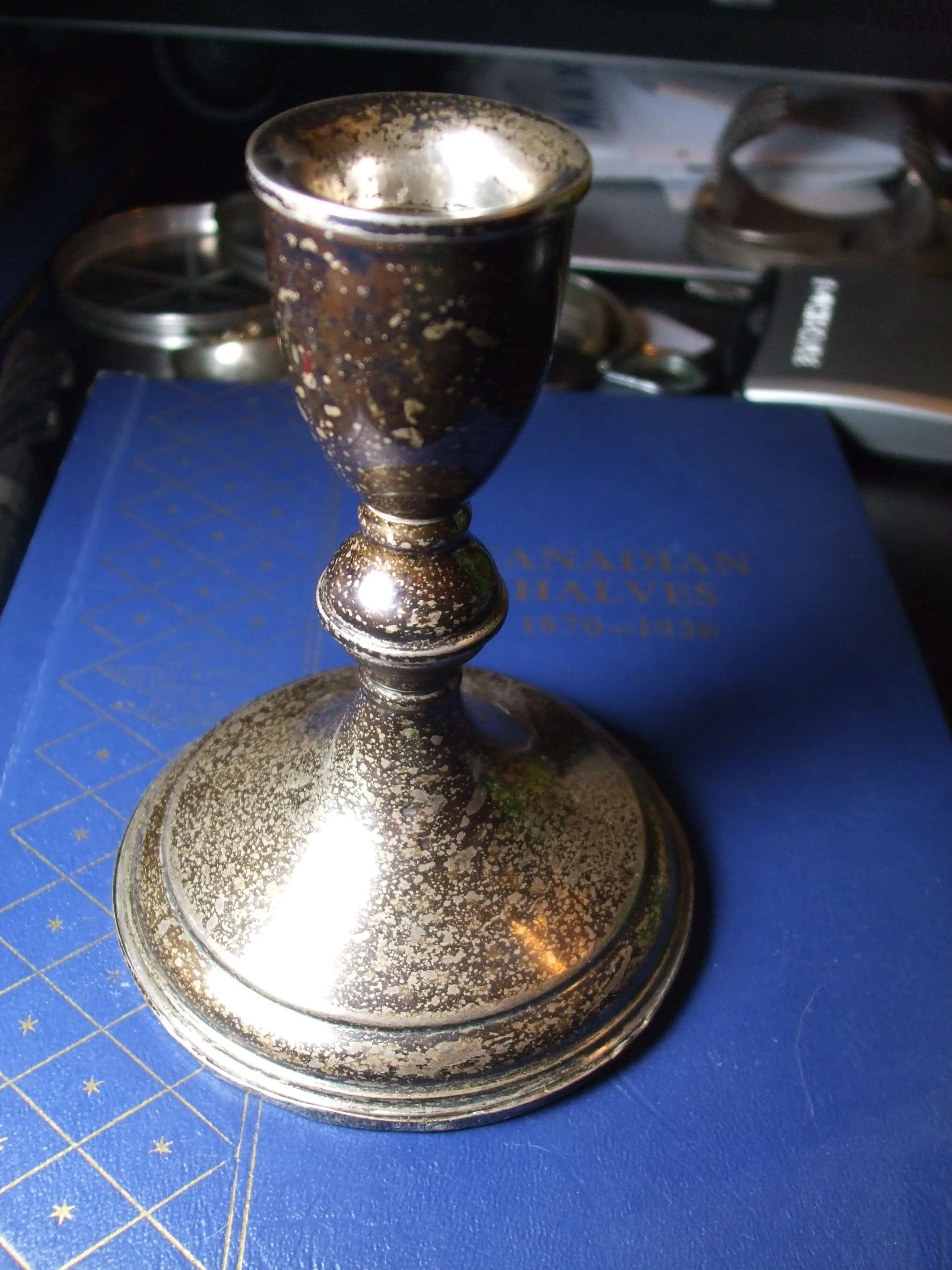

hi all,
i picked this up at goodwill today and i managed to get the bottom off neatly but i was wondering if it is possable to get the weight out without destroying the piece?
thanks

The ones I have scrapped have a resin that will melt in the bottom part, and plaster in the part that holds the candle, which won't melt. Also wooden dowels where the resin and plaster meet. Don't remember what temperature it takes to melt the resin though. I pulled mine apart with a pair of pliers and melted the pieces into an ingot anyway.

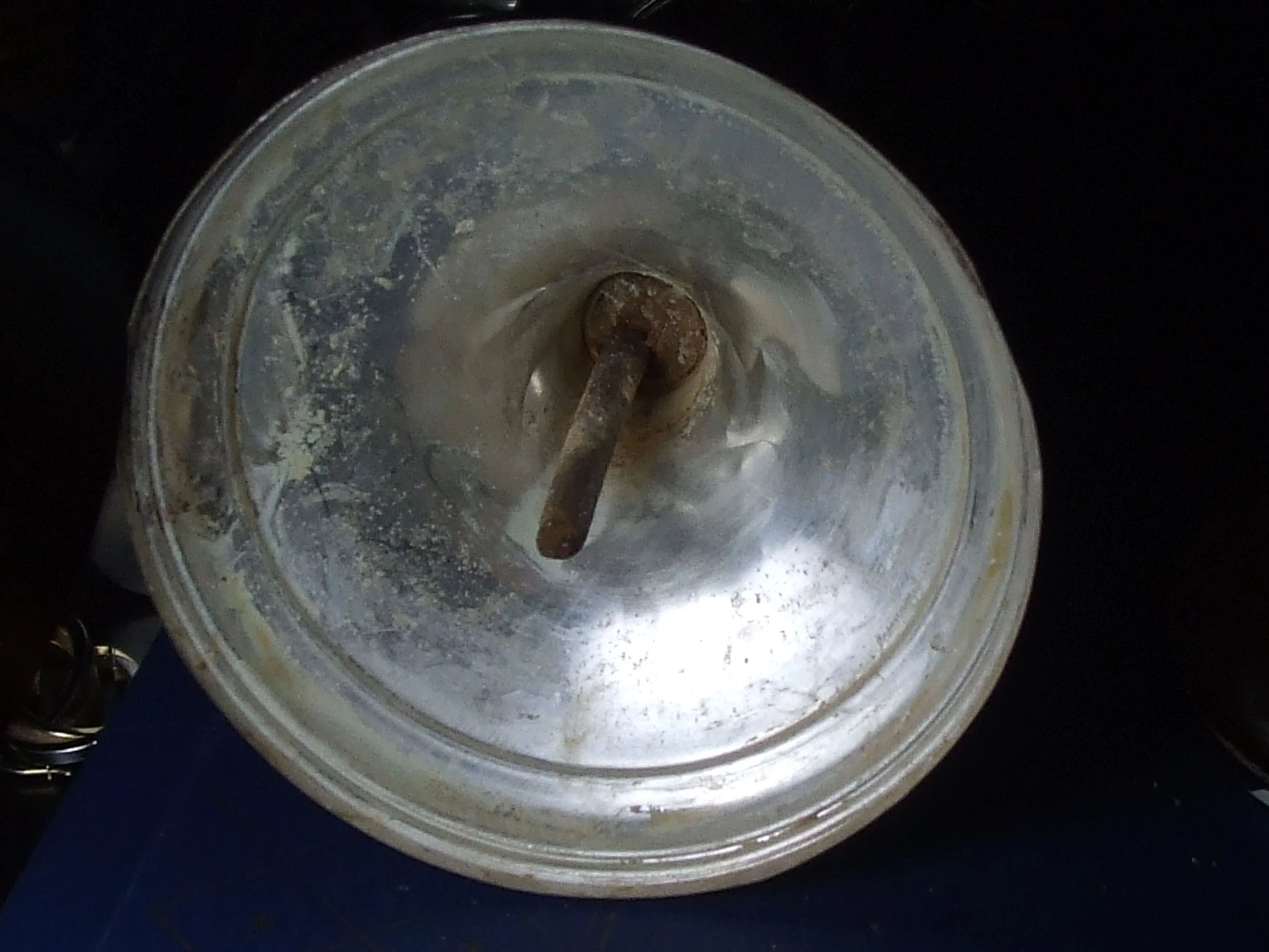

by smacking the bottom with my palm the resin cracked and i was able to get the large chunk out but now the is a metal rod going through the top

I put em in the freezer a while and the resin will then shatter like a frozen chocolate bar and that'll generally break free all the resin from the rod with a few smack's with a hammer. Then I smash all the silver flat.

You might be able to melt it out in a toaster oven, outside. I have melted out the resin in sterling knife handles with a torch before, it drips out, but it also burns. Also, you will get firescale on the silver if you heat it in the presence of oxygen.

There is scrap silver value in them. The small ones yeild around 19 grams each I have found on average and that's how I base the amount of silver in the taller ones. I won't pay any more than 5 bucks each for these short sterling weighted candlesticks anymore. I strip them down and take them to my local coin shop - precious metal buyer, because he's got all kinds of other cool stuff he'll take these in on trade, but he won't give even half the value if you don't strip them down. If they don't say sterling on them, they ain't worth poop.
