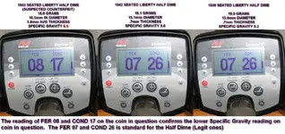

Here are the results of testing today, the photos showing where the particular coins read on the digital readout and the data I gathered on each coin. The Specific Gravity reading of a lower number on the coin in question, proves it is not of the same metal content as the two other half dimes I measured today. The detector readings and and Specific Gravity readings are in agreement with each, indicating counterfeit.
So, original question still there, how did this happen?
:icon_scratch:
Don
