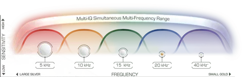

It is running Multi-IQ which consists of 5. 10, 15, 20 and 40 khz all being transmitted at same time.
Here is link to Minelab Equinox, Vanquish runs same 5 frequencies, Equinox you can pick individual or run all 5, Vanquish you don't have the option to select single frequencies.

That picture is for the Equinox 800. Don't go off the picture, scroll down to the real specifications.
Equinox 800 specs: MULTI-IQ 5, 10, 15, 20, 40
Equinox 600 specs: MULTI-IQ 5, 10, 15
Vanquish 540: Just says MULTI-IQ, so likely only 5, 10, 15 like the Equinox 600 or perhaps only 5, 10
I would call Minelab and ask them why they don't list the true frequencies for the Vanquish 540

Multi-IQ technology is one of Minelab’s most impressive technological advancements. This technology allows the detector to function on multiple frequencies at once. Rather than having adjustable frequencies, this line of detectors can operate on all 5 of the frequencies simultaneously. The Vanquish line cannot operate on single frequencies, unlike some of Minelab’s other multiple frequency detectors. Operating frequencies are: 5 kHz, 10 kHz, 15 kHz, 20 kHz, and 40 kHz. The lower frequencies are best for highly conductive metals like silver, while the higher frequencies are best for lower conductivity metals like gold.
