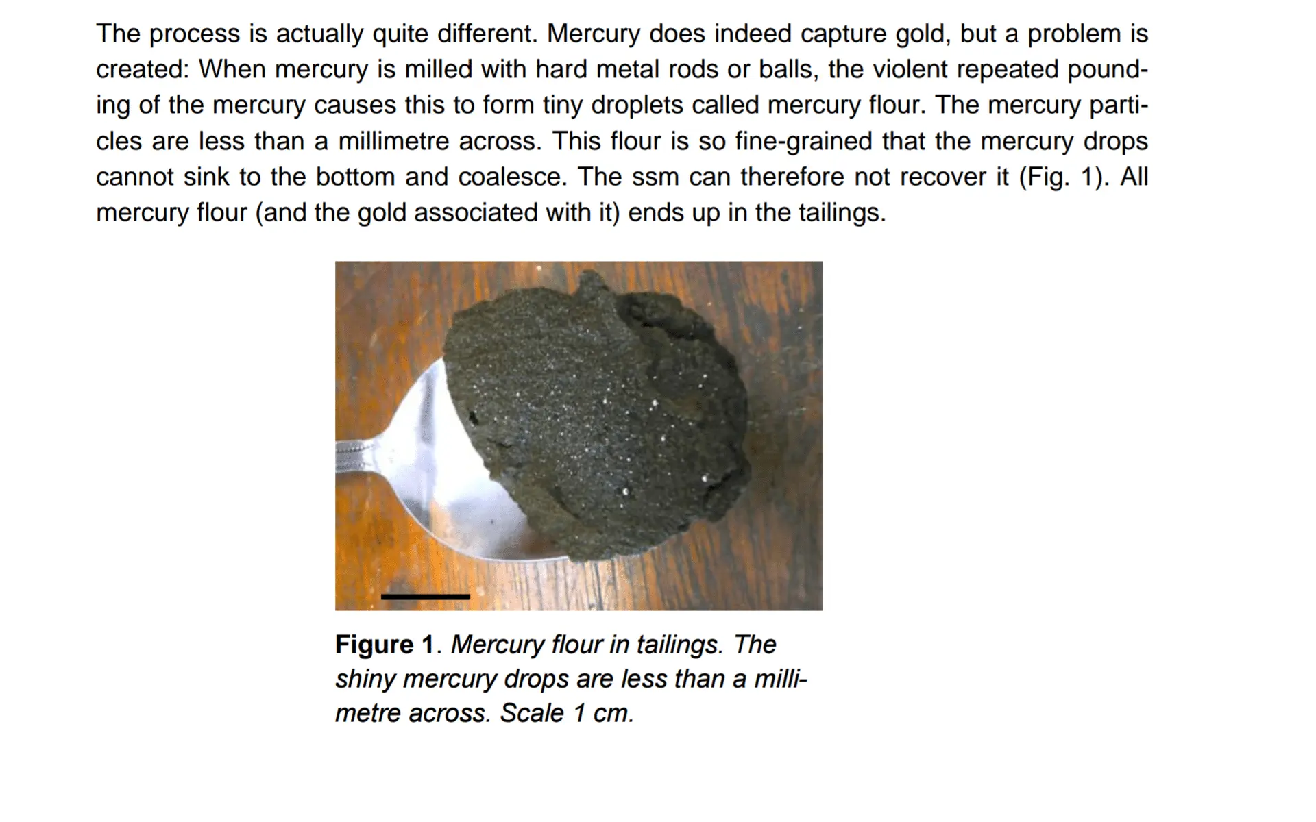

If it were up to me(it isn't) I would roast the BS, and put it under a microscope to determine values. Then do a crushing operation in a drum amalgamotor, then merc it, and run it thru a retort. I do appreciate all of your fine remarks!It would be best if it were processed on site, but that opens up another can of night crawlers! It may have to be shipped to a major refiner for processing.
"The Devil is in the details" As I find out more, I will let you in on that.
