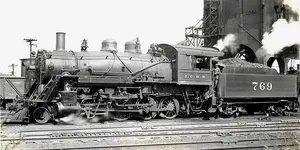

Looks like it was originally round, so maybe a type of hose clamp from an old coal or steam locomotive? :icon_scratch:

:icon_thumright: Could be Dave .. I was thinking along the lines of any emergency pipe clamp, too!

I agree and the *crank is actually bent. Could be a signal lamp or one of those lamps on the front of a steam train?
