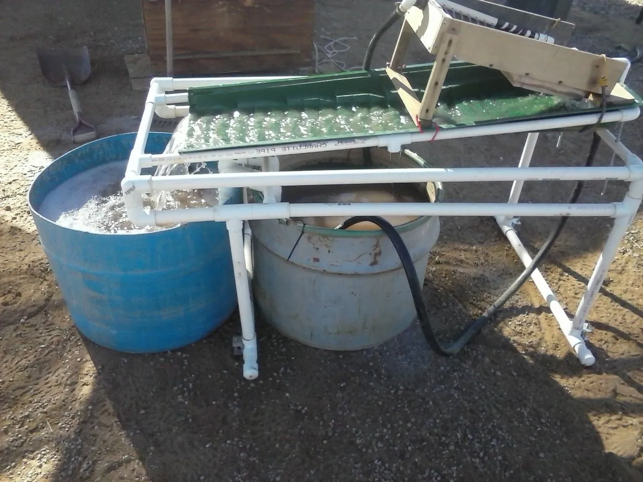

Since I'm in the desert, if I want to sluice (which I prefer) I have to use a recirculating system. I've spent the last few years trying many different pumps and sluice combinations and I currently am using a Le' Trap with a homemade header box. Even though I use two pumps, one for the box and one for the spray bars, I feel I could use a little more flow. I'll be upgrading the main box to a Johnson 4000 gph and moving the current 1500 gph up to the spray bars. This will allow me to run the sluice at a much flatter angle and still have it clear the lighter materials.
Here's a shot of my current setup. It's light, portable and works great. The stand breaks down for transport and is still very stable.
EDIT: From start to finish, clean out take me 2-1/2 minutes from start to being back to ready to run more materials through it.
