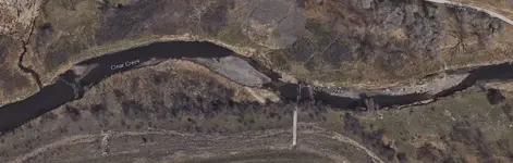

Check this out and where would you all dig? You can see how the cobble stones build up after the curves. This is a super public spot that is crowded anyway. It's not like I'm giving up some super secret spot.

On that map it looks like some unnatural gravel bar. Some parts have been dug. Find the parts that haven't.
