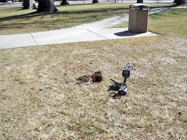

I routinely get Wheats and Silver Dimes in the 8 to 10 inch range with the V3. These are not just stories. My deepest is a Wheat at 11 inches just a few weeks ago. Try the following to get deeper on your test garden coin. Soils vary, mine is moderate in strength. Use the D2 coil. DD style coils will get better depth than a concentric coil in all but very low mineralization strength soils.
1. Set your filter to 5.0 Hz Band Pass. If your EMI is low then try the 5.0 Hz High (High Pass Filtering) as it will will get you a little deeper.
2. Slow your swing speed down and keep the coil on the ground if possible. This works well in grassed areas like old parks. Your swing must be rhythmic, consistent, and slowwwwww.
3. Use Correlate and set your wrap to -94 or -93. This can get noisy, so adjust accordingly if you have hot rock issues.
4. Adjust your Discrimination Sensitivity to 92 to 94. Set your RX Gain to 10 to 12 (this is the sweet spot for me)
5. Try locking your Ground Tracking down, and Ground Balance Often.
Keep in mind that the above settings are a starting point. You will need to adjust for your environment. If your ground is higher in Mineralization strength you may need a slightly higher Filter setting.
Keep Swing'in
Jack
Indian at 10 inches
Another Indian at 10.5 inches
