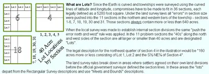

The Lot 1 notation differs from what we frequently see. It would typically appear as the NE 1/4 of the NE 1/4 but in this case adjustments had to be made and hence the Lot notation.

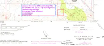

I searched the USGS maps In los Angeles County until I found the Ritter Ridge Topo that contained the Township 5N and Range 12W notations. (Left Side of Image)
The Ritter Ridge topo I chose was a 15 minute map that was updated in 1958. This map would reflect the roads, and features that Laurence would have seen when he was acquiring the land.
I'm repeating one of the previous images that contains the 52 acre plot and shows the Township notations in respect to Larry's plot. T5N and T6N (Right Hand Side of Map).
You can see the Section numbers within each rectangle and you can now locate the properties on the Topo.
Earlier in the thread sdcfia posted maps that indicated the property was near Palmdale and my analysis is in agreement with that.
The mapping results for the properties in LA County I got from the link I posted above exactly matched this map
A nice feature of that site is that it offers land ownership records from public records. So for these three LA County properties, you can right click on them and choose Land Patents from the Records box, and up pops info on our Willie.
