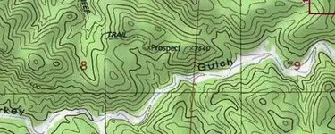

Hi Everyone,
I have been using some topo software to map out areas I want to research.
On the topo is a common mark. It is either an X or two crossed picks. It has the word Prospect next to it.
Now, I understand what prospecting is but I am curious what had to happen for this prospecting site to have ended up on a topo map. Does it mean a claim was filed? Is there a hole in the ground at the location?
Here is a screen shot showing what I am referencing.
Any ideas or thoughts?
Patrick
Go look. Old maps had a lot of marks. That looks like it is a small gully near some peaks. First find the jeep trail. Then search out the "prospect ".

I did the search and even exchanged some email with the folks at the USGS. My question isn't what is prospecting. Its more about how it ended up on the map. I mean, I know what prospecting is.
That one in the picture is right down the road from me. I was in there scouting out the area but did not see any evidence of mining. It more looks like a dry river bed. I will go back over there this weekend and look closer. (I did not see the marking on the map until after I came home and was researching the area where I was driving on the jeep trail. Its adjacent to BLM land.
When I look at the topo map software, the X Prospect is everywhere in the mountains and such. It is a common mark. The legends just say Prospect or something as nondescript.
This is national geographic software for topo maps by state. It allows me to put any amount of notes, pictures, research information, etc., at a location like a thumbtack. It can find a place by GPS coordinates. Its a cool tool.
I just can't figure out how the X Prospect location came to be identified and registered with National Geographic to appear in a specific location on their TOPO maps. I was in the area where that map was representing. There were no claim markers of any kind.

These are from old USGS maps I would guess. Any sign of the old jeep road?
A shallow pit excavated for the purpose of exposing mineralization and/or extracting sample material. Named a “Prospect” in the USGS topographic map legend.
