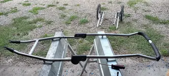

Started making the frame and flotation for my dredge. Its gonna be on detachable wheels.

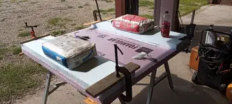

Got some of the foam board glued up. This is a long slow process.

That foam is gonna take a beating going to and from the stream ,plus while in the stream going over boulders and such. MAYBE wrapping the foam with some plastic basement foundation wrap to protect the foam from gouging or any pieces from getting broke off . On my 4 inch dredge I made my yellow floats ( Keene )so they will be EZ to attach / detach with quick release pins . It made my trip to the stream better for me to handle in the process .
Ya, gonna glass it like a surfboard. It will be extremely light weight, compared to the premade floats.
